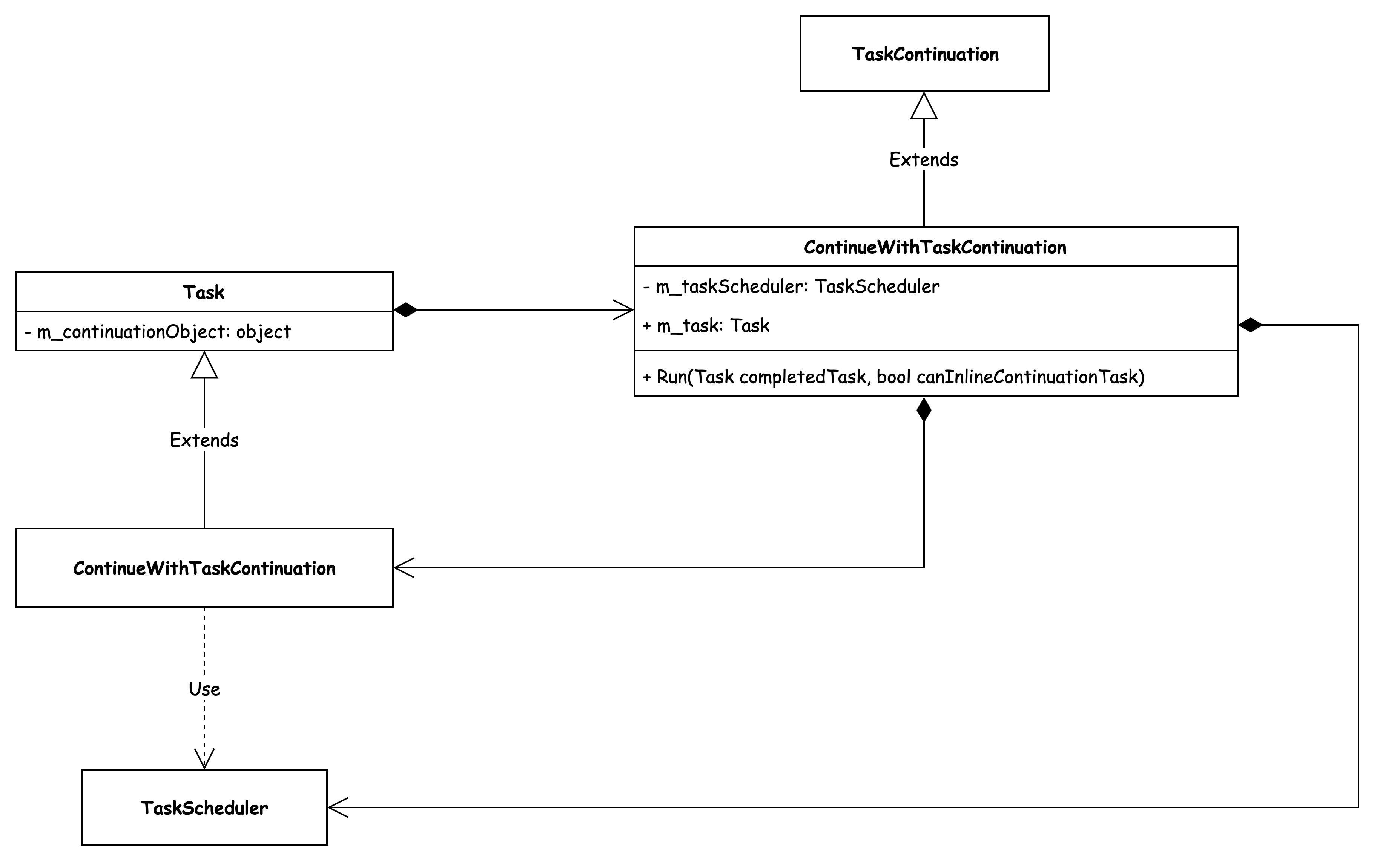

回调的容器:TaskContinuation
我们注意到 m_continuationObject 字段的类型是 object,而 object 类型在数据的存储上有更多的灵活性。
class Task
    // 保存一个或一组回调
    private volatile object m_continuationObject;

ContinueWithTaskContinuation 的父类 TaskContinuation 是一个抽象类。除了 ContinueWithTaskContinuation,还有别的实现。
internal abstract class TaskContinuation
    internal abstract void Run(Task completedTask, bool canInlineContinuationTask);
ContinueWithTaskContinuation 维护着 Task 执行相关的两个核心对象,一个是 Task 本身,另一是 TaskScheduler。真正执行回调之前,需要先调用 TaskContinuation.Run。
internal sealed class ContinueWithTaskContinuation : TaskContinuation
    internal Task? m_task;
    internal readonly TaskContinuationOptions m_options;
    private readonly TaskScheduler m_taskScheduler;
    internal ContinueWithTaskContinuation(Task task, TaskContinuationOptions options, TaskScheduler scheduler)
        m_task = task;
        m_options = options;
        m_taskScheduler = scheduler;
    internal override void Run(Task completedTask, bool canInlineContinuationTask)

回调执行真正的决定者:ContinueWithTaskContinuation
在 ContinueWithTaskContinuation 中维护着待执行的 ContinuationTask 以及决定 ContinuationTask 最终执行方式的 TaskContinuationOptions 和 TaskScheduler。
        m_task = task;
        Task? continuationTask = m_task;
        m_task = null;
        // 检查任务的完成状态,如果不符合 TaskContinuationOptions 的设置,回调就不会被执行
        TaskContinuationOptions options = m_options;
        bool isRightKind =
            completedTask.IsCompletedSuccessfully ?
                (options & TaskContinuationOptions.NotOnRanToCompletion) == 0 :
                (completedTask.IsCanceled ?
                    (options & TaskContinuationOptions.NotOnCanceled) == 0 :
                    (options & TaskContinuationOptions.NotOnFaulted) == 0);
        // 任务完成状态符合要求,回调执行。
        if (isRightKind)
            continuationTask.m_taskScheduler = m_taskScheduler;
            // 直接执行回调或将其排队等待执行,具体取决于是否需要同步或异步执行。
            // 默认执行路径,上层传的是 true。
            if (canInlineContinuationTask && // 调用Run方法的内部方法传了允许内联
                (options & TaskContinuationOptions.ExecuteSynchronously) != 0) // 注册回调的实际用户设置了同步执行
                InlineIfPossibleOrElseQueue(continuationTask, needsProtection: true);
            else
                try { continuationTask.ScheduleAndStart(needsProtection: true); }
                catch (TaskSchedulerException)
                    // 如果 Task 执行失败了,ScheduleAndStart 方法会将 Task 标记为失败,
                    // 这里是runtime设计的时候保证不会有意外的错误发生,仅做catch,不做处理
        else
            Task.ContingentProperties? cp = continuationTask.m_contingentProperties;
            if (cp is null || cp.m_cancellationToken == default)
                continuationTask.InternalCancelContinueWithInitialState();
            else
                continuationTask.InternalCancel();

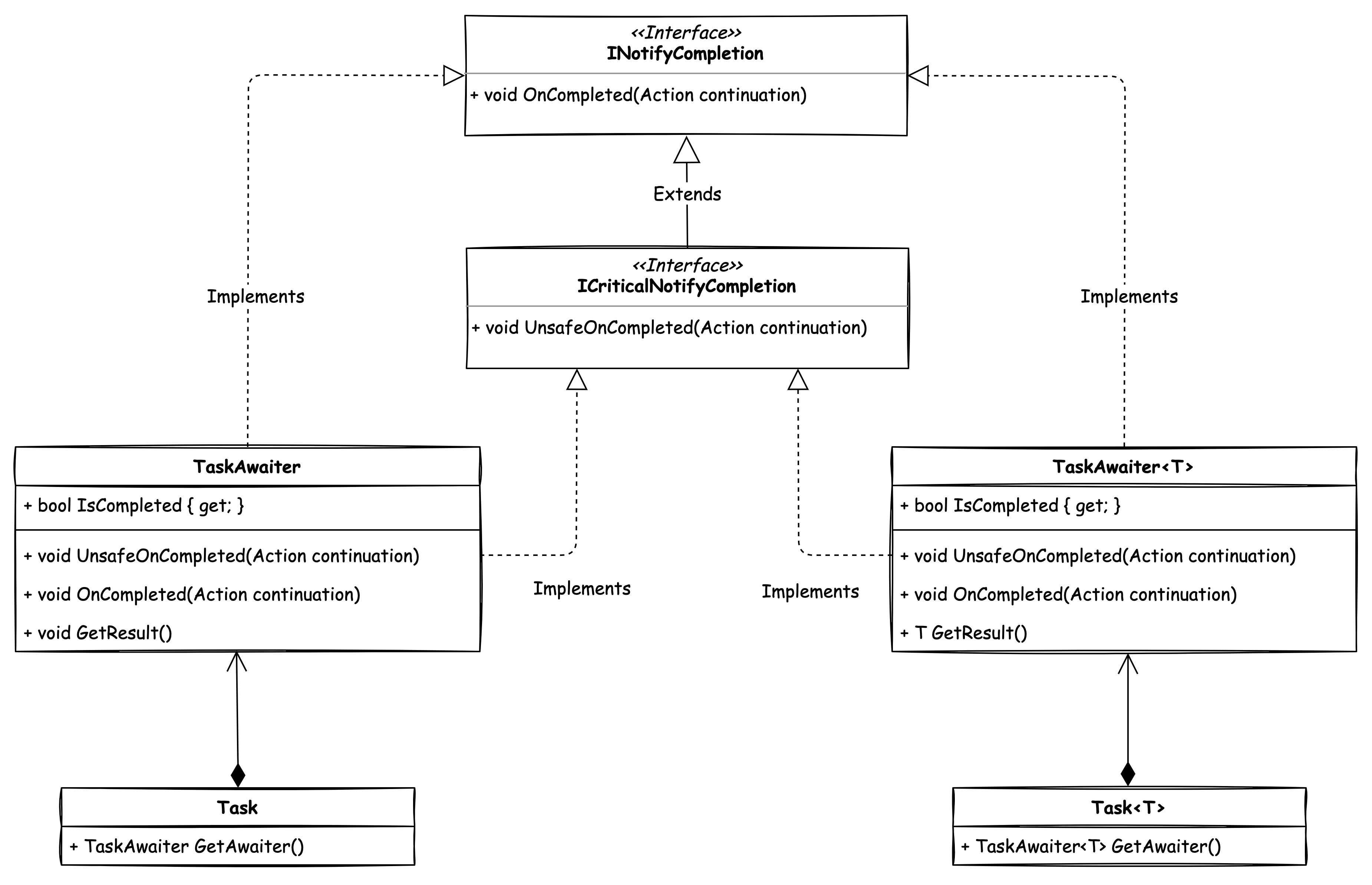

Task 与 await
与 ContinueWith 相比,await 给我们提供了更加简单的 Task 的使用方式。
Task.Run(() => "Hello")
    .ContinueWith(t => Console.WriteLine($"{t.Result} World"));
// 等效于
var result = await Task.Run(() => "Hello");
Console.WriteLine($"{result} World");
Awaiter
我们可以通过 Task.GetAwaiter 从 Task 实例上获取到 Task 对应的 TaskAwaiter 对象。并且可以通过 TaskAwaiter.OnCompleted 方法注册回调,其执行结果与 Task.ContinueWith 一致。
TaskAwaiter awaiter1 = Task.Run(()=> Console.WriteLine("Hello")).GetAwaiter();
awaiter1.OnCompleted(()=> Console.WriteLine("World"));
TaskAwaiter<string> awaiter2 = Task.Run(()=> "Hello").GetAwaiter();
awaiter2.OnCompleted(()=> Console.WriteLine($"{awaiter2.GetResult()} World"));
Console.ReadKey();
Hello World
Hello
World
注意:直接调用 TaskAwaiter.GetResult 会阻塞调用线程直至 Task 执行完成。
TaskAwaiter 本质上可以理解成在 await 语法糖编译成的代码中,为了解耦 Task 和状态机,而创建的一个隔离层,内部对 Task 进行了包装。
public class Task<TResult>
    public TaskAwaiter<TResult> GetAwaiter() => new TaskAwaiter<TResult>(this);
    internal void SetContinuationForAwait(
        Action continuationAction, bool continueOnCapturedContext, bool flowExecutionContext)
        TaskContinuation? tc = null;
        if (continueOnCapturedContext)
            SynchronizationContext? syncCtx = SynchronizationContext.Current;
            if (syncCtx != null && syncCtx.GetType() != typeof(SynchronizationContext))
                tc = new SynchronizationContextAwaitTaskContinuation(syncCtx, continuationAction, flowExecutionContext);
            else
                TaskScheduler? scheduler = TaskScheduler.InternalCurrent;
                if (scheduler != null && scheduler != TaskScheduler.Default)
                    tc = new TaskSchedulerAwaitTaskContinuation(scheduler, continuationAction, flowExecutionContext);
        if (tc == null && flowExecutionContext)
            tc = new AwaitTaskContinuation(continuationAction, flowExecutionContext: true);
        if (tc != null)
            if (!AddTaskContinuation(tc, addBeforeOthers: false))
                tc.Run(this, canInlineContinuationTask: false);
        else
            if (!AddTaskContinuation(continuationAction, addBeforeOthers: false))
                AwaitTaskContinuation.UnsafeScheduleAction(continuationAction, this);
public readonly struct TaskAwaiter<TResult> :
    ICriticalNotifyCompletion,
    INotifyCompletion,
    ITaskAwaiter
    private readonly Task<TResult> m_task;
    internal TaskAwaiter(Task task)
        m_task = task;
    public bool IsCompleted => m_task.IsCompleted;
    public void OnCompleted(Action continuation)
        TaskAwaiter.OnCompletedInternal(m_task, continuation, continueOnCapturedContext: true,
    public void UnsafeOnCompleted(Action continuation)
            flowExecutionContext: false);
    [StackTraceHidden]
    public TResult GetResult()
        TaskAwaiter.ValidateEnd((Task)this.m_task);
        return this.m_task.ResultOnSuccess;
    internal static void OnCompletedInternal(
        Task task,
        Action continuation,
        task.SetContinuationForAwait(continuation, continueOnCapturedContext, flowExecutionContext);
可以看到 TaskAwaiter.OnCompleted 就是往 Task 注册回调,而 await 关键词的本质就是把 await 后面的代码变成了回调并注册到了 Task 上。

一旦实现了 ICriticalNotifyCompletion(INotifyCompletion 的子接口),注册回调走的是 UnsafeOnCompleted 方法。如果同时实现两个方法,也还是以ICriticalNotifyCompletion 的规则优先。
INotifyCompletion VS ICriticalNotifyCompletion
既然实现 Awaitable 只要实现两个接口之一,那为什么要区分出这两个接口呢。
我们来看看 TaskAwaiter 里的实现是什么样。
public readonly struct TaskAwaiter<TResult> : ICriticalNotifyCompletion, INotifyCompletion
    internal TaskAwaiter(Task<TResult> task)
        m_task = task;
        TaskAwaiter.OnCompletedInternal(m_task, continuation, continueOnCapturedContext: true, flowExecutionContext: true);
        TaskAwaiter.OnCompletedInternal(m_task, continuation, continueOnCapturedContext: true, flowExecutionContext: false);
        Task task,
        m_task.SetContinuationForAwait(continuation, continueOnCapturedContext, flowExecutionContext);
OnCompleted 和 UnsafeOnCompleted 的唯一区别是在调用 TaskAwaiter.OnCompletedInternal 时,flowExecutionContext 这个参数有所不同。
ExecutionContext 的本质是一个线程私有变量,维护着我们常用 AsyncLocal 的数据,例如 Thread.CurrentThread.CurrentCulture 其实就是一个 AsyncLocal 变量。
runtime 中会在发生线程切换的地方,将 ExecutionContext 从前一个线程拷贝到后一个线程。那么第二个线程里也就可以拿到在第一个线程里设置好的 AsyncLocal 变量。
就算线程没有发生切换,runtime 里有的地方也会通过清空 ExecutionContext 来阻止其往后传播。
更多 ExcutionContext 和 AsyncLocal 的解析,请参考我之前的一篇博客:
https://www.cnblogs.com/eventhorizon/p/12240767.html
也就是说 OnCompleted 会保证 ExecutionContext 往后传播。而 UnsafeOnCompleted 则不会。我们来看下面这个示例。

如果像上文那样自己实现 Awaitable,会调用 TaskAwaiter.OnCompleted 或者 TaskAwaiter.OnCompleted 方法。这个和 AsyncMethodBuilder 内部的实现有关。(手动狗头,设计的太复杂了)

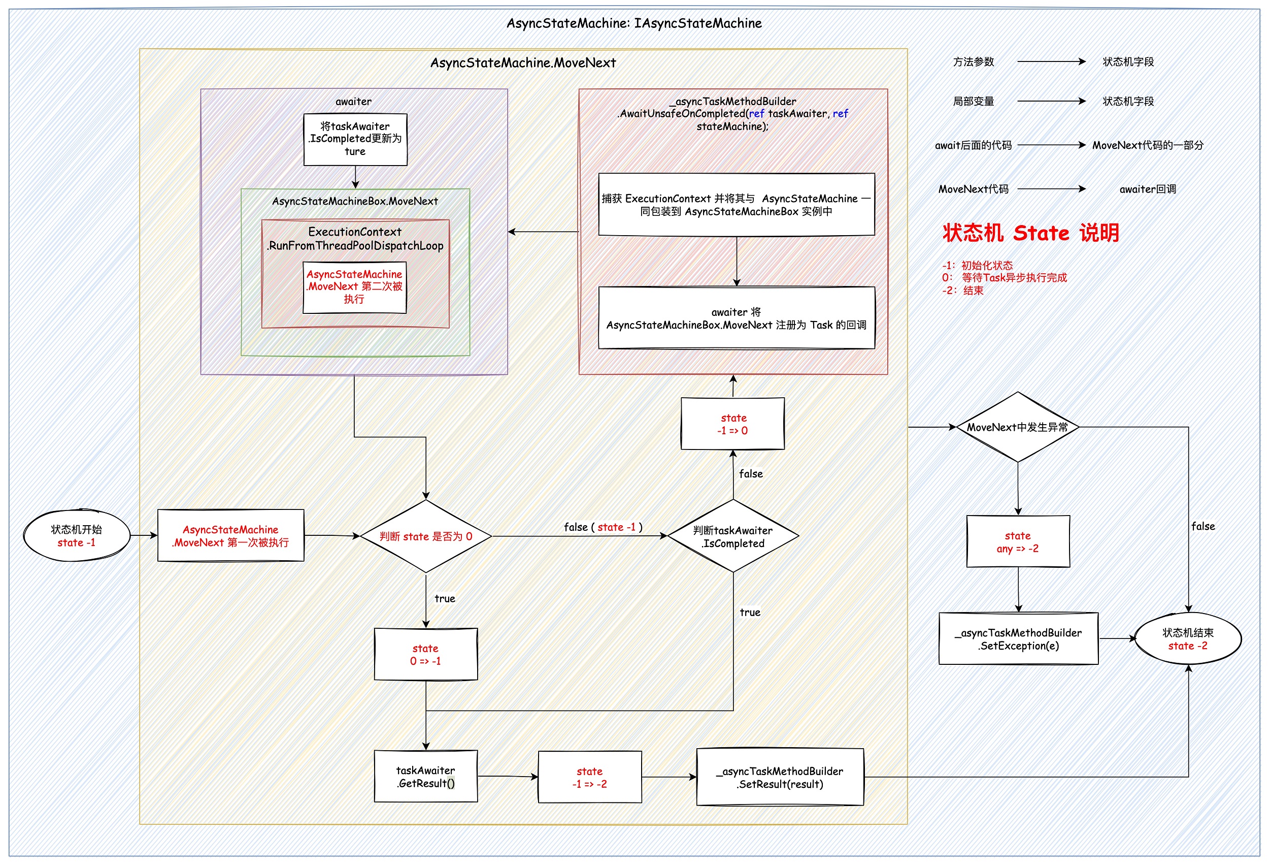

完整的流程如下图所示:
一个方法中就算有个 await,这个方法也只会有一个对应的状态机。就.NET 6 SDK 的编译结果来看,state 会出现 -1 => 0(等待第一个Task异步执行完成) => -1 => 0(等待第二个Task异步执行完成)这样的流程。

回忆一下上文 Task.ContinueWith 讲回调最终封装到了 ContinueWithTaskContinuation。
返回值是 Task 的情况下状态机所绑定的 AsyncTaskMethodBuilder 的所会调用 Task.UnsafeSetContinuationForAwait 实例方法。里面会根据不同的条件创建不同的 TaskContinuation。
UnsafeSetContinuationForAwait 中的逻辑和后续回调执行流程大致如下:
